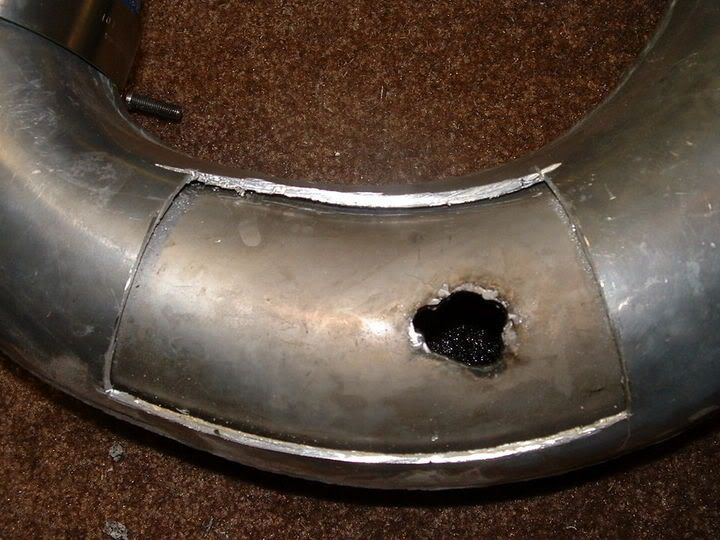

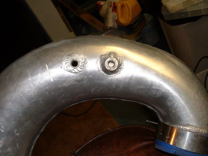

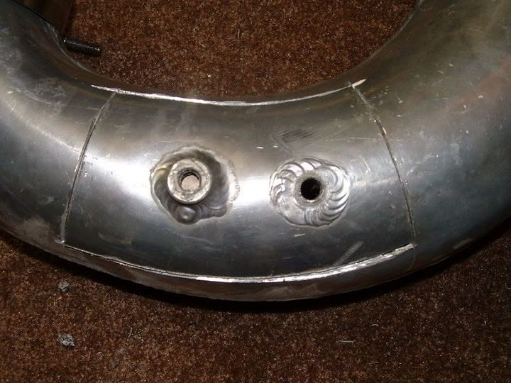

              Glad you found the problem, but it sucks that your pipe is cracked. Depending on where it is cracked it might not be repairable. The most common place they crack is around where the fitting on the bottom of the headpipe goes through the inner wall. To fix this you need to cut a hole in the outer wall to get access & then weld a patch back to the outer wall to close it up - see picture.
              The pipe I am currently running has had one minor external repair. The pipe in the pictures above has been repaired several times and I now keep it as a back up.
              I found a welder locally who knows how to weld aluminum - does a good job. Even though I have spent thousands with Rossier they won't give me the time of day. I once bought a pipe from them that cracked in the first two hours and they wouldn't cover it. Basically they say if the pipe cracked there must be something wrong with the ski.
              Find out where the crack is and get a local welder. You might also be able to get Coffman to fix it since they made the pipes for Rossier. Or try Jim Budnick in Michigan (on Snky Pete & Team Tweek forum), I think he can weld these.

                  Well here it is- Dan I'm almost positive this is where your pipes were leaking from too. This should be a fairly easy fix- whatever company manufactured these pipes needs to get a more qualified welder. The point that the pipe "cracked" wasn't actually a crack it was a very poor penetrating weld that allowed the water injection bung to vibrate loose and tear the pipe. SHOOTER- wanna buy a Rossi pipe?> HAHA

                            Bri/fedorov5549- those instructions were written before Rossier started recommending a Microtouch Water Controller & Solenoid to inject water at the head pipe. I have ran the Rossier Pipe both with and without the water injection in several different set-ups and it always ran better with the water injection. I will attach some pic's to help clarify thje Rossier instructions.
