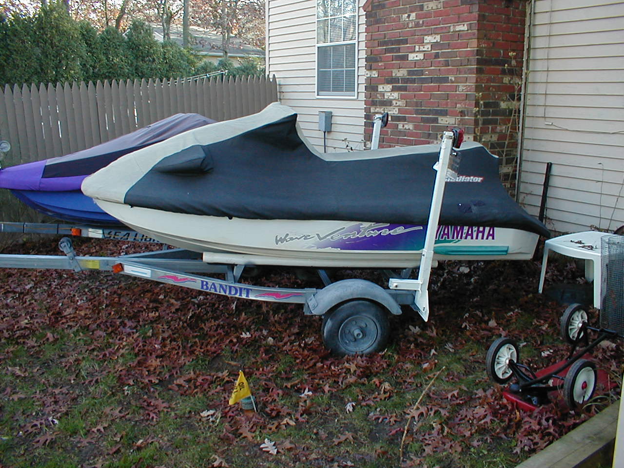

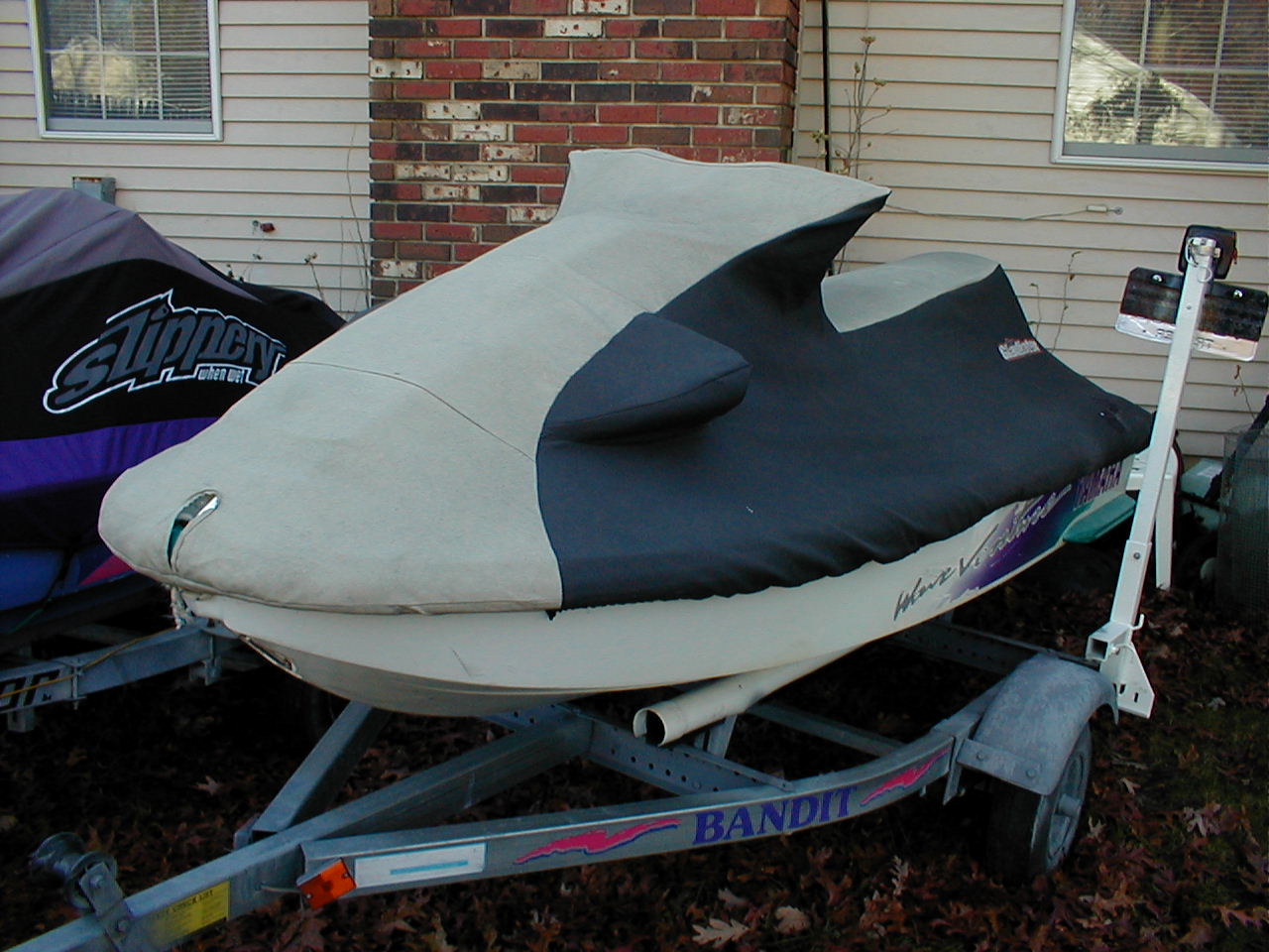

          I left the wooden bunks in place. Cut the PVC lengthwise so it would spread open. Put the PVC over the wooden bunks. Works fine with my 95 Waveventure on it. I have travelled on local roads and the parkway with no problem. The wood bunks provide the strength and the PVC provides the no scratch surface. Only thing surprising is it does not slide on and off as easily as I expected. I guess that's a good thing though. I would be a little afraid of the super slippery stuff. I've seen a couple of stories of people who forgot how slippery the glides are and have dropped their ski's on the ground.
          Never thought to take a picture and can't get any at the moment due to a couple foot of snow.

            And now I see I do have a couple of pics. The ski is usually about 2 foot forward when I trailer. In these pics it is pushed back to take the weight off the tongue. That way I can tilt it up when it's parked, helps the rain and snow run off.
