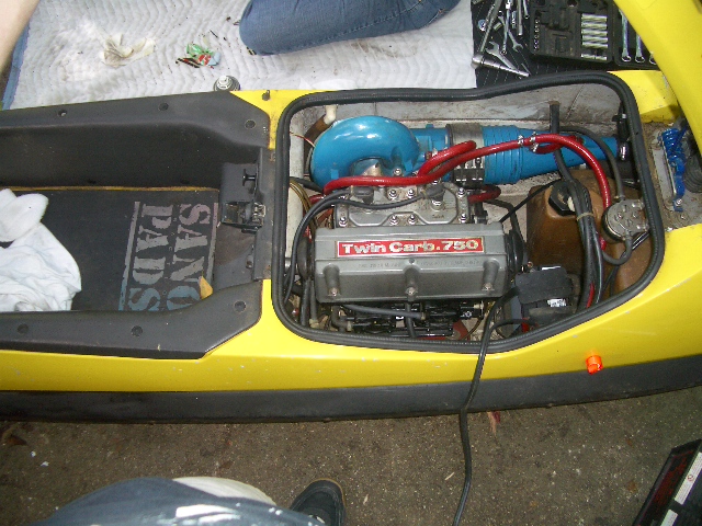

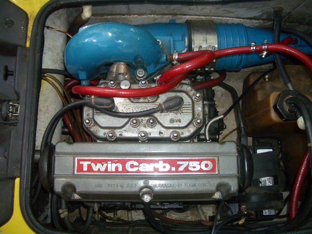

        It's a good question. Can you post a picture of the engine? It could be a 750. BONUS for you if it is.
          Re: 650sx standup engine conversion
          Here are two shots of the ski/engine...

                          dsolie, it is not a regular hose he need, it is the blue hose in the picture.
                          Replace it with a water box there is some brands on the market and check out ebay and/or othere online auctions

                            DS- Looking at your pictures you have a 750 engine with a Westcoast pipe and exhaust manifold. Your running a 650 stator and front cover, your 750 cases have been machined for these mods.
                            It also sounds like you have had a closed throttle run away which usually an indication of some sort of air leak.You could test this out by doing a compression test on the top end and a pressure test on the bottom end.
                            If you can't find the parts for you supertrapp, just get an oem or aftermarket waterbox. Try some of the salvage yards for that supertrapp. Good luck.
