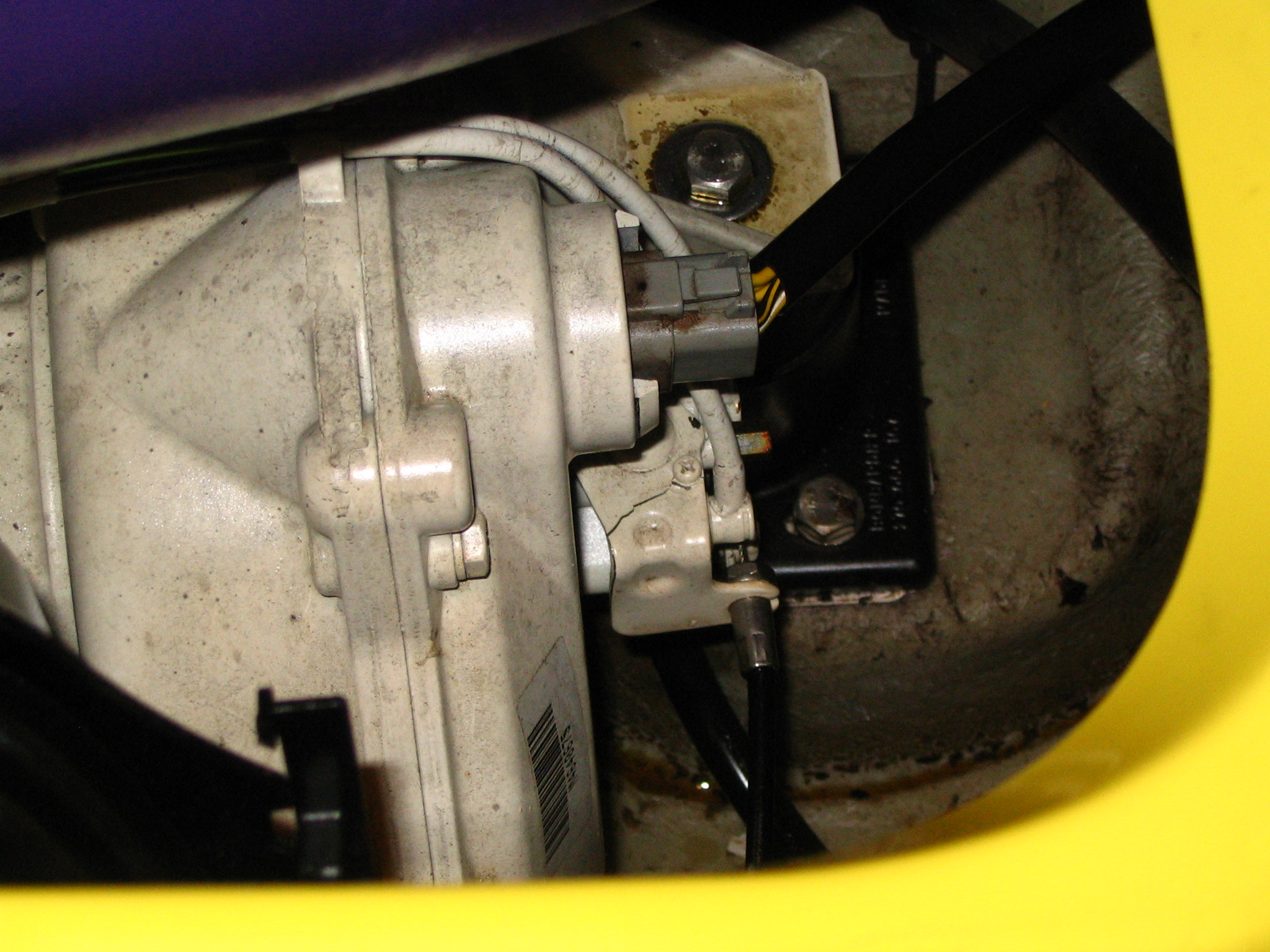

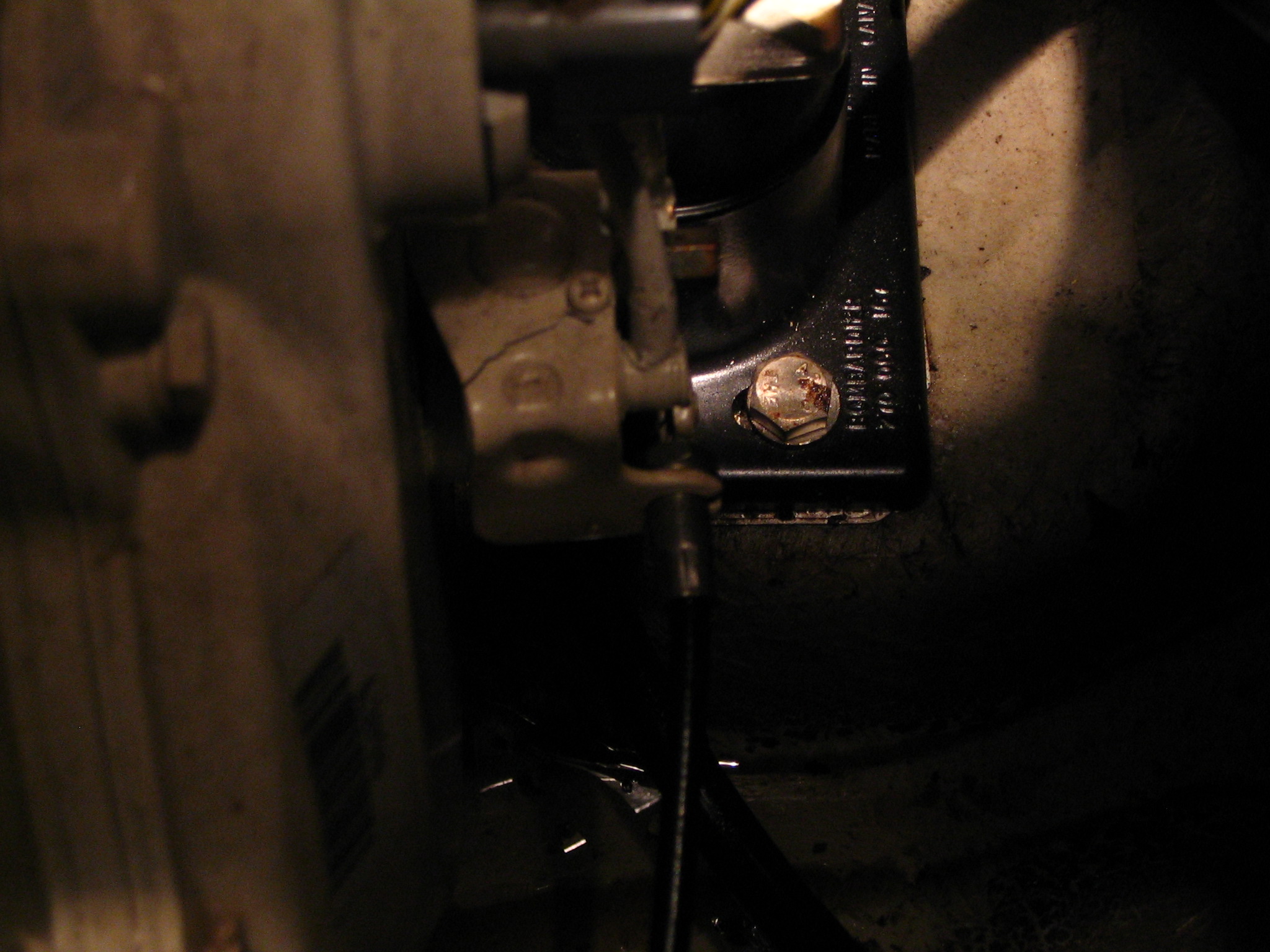

                        With all of this talk about the oil pump and my original concern, I had a look at one of my ski's and found this crack on the bracket holding the pump cable.
                        Any comments?
                        Tom
                        • #13
                          Re: Oil Pump Adjustments?
                          get a new bracket, maybe someone has a junk pump tey dont need. or u can weld it back up.

                            Tman, that's disturbing! It looks like a clean hairline fracture...ie: At least rust is predictable!

                              1.) That's not from rust; Fractures like that are from vibration.
