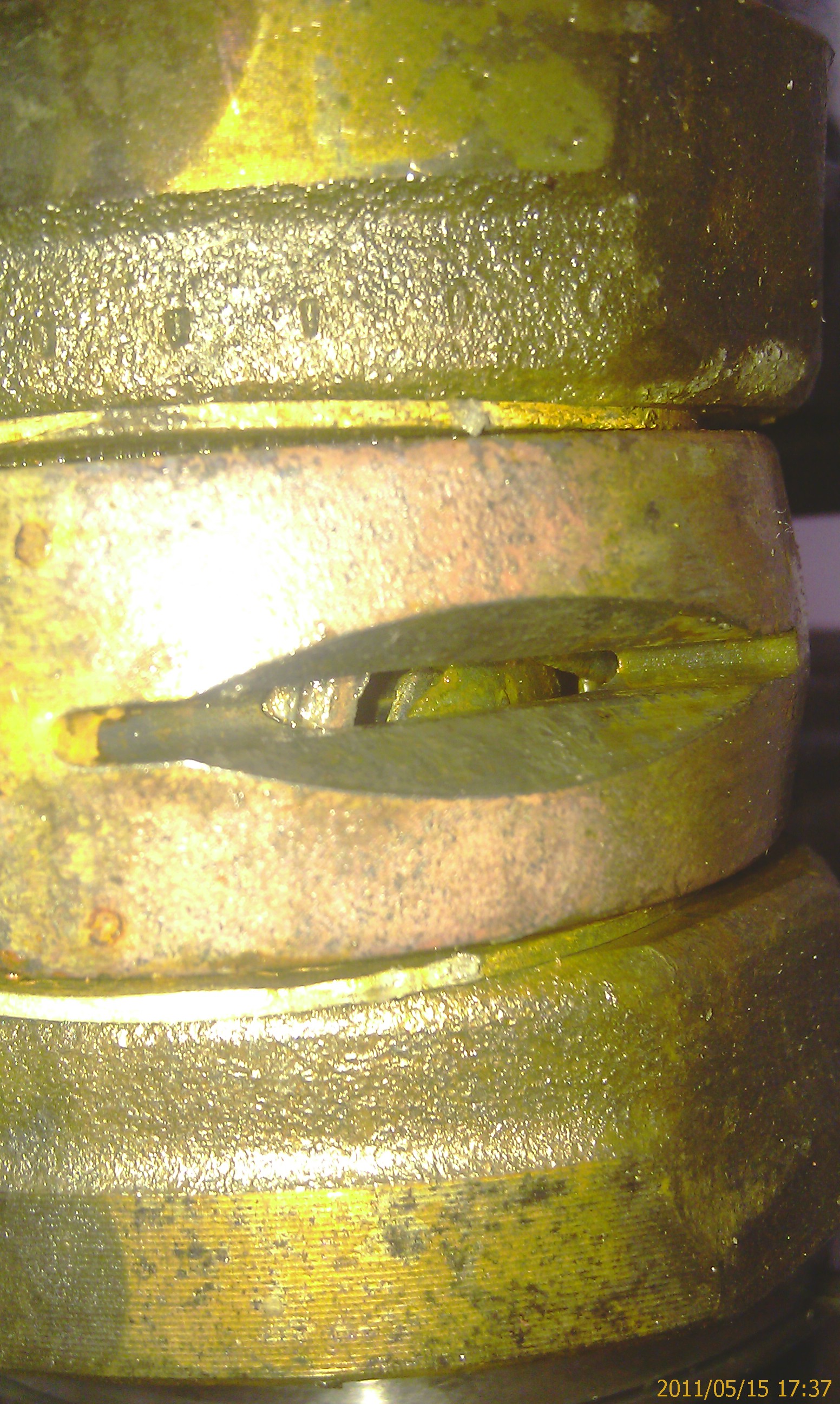

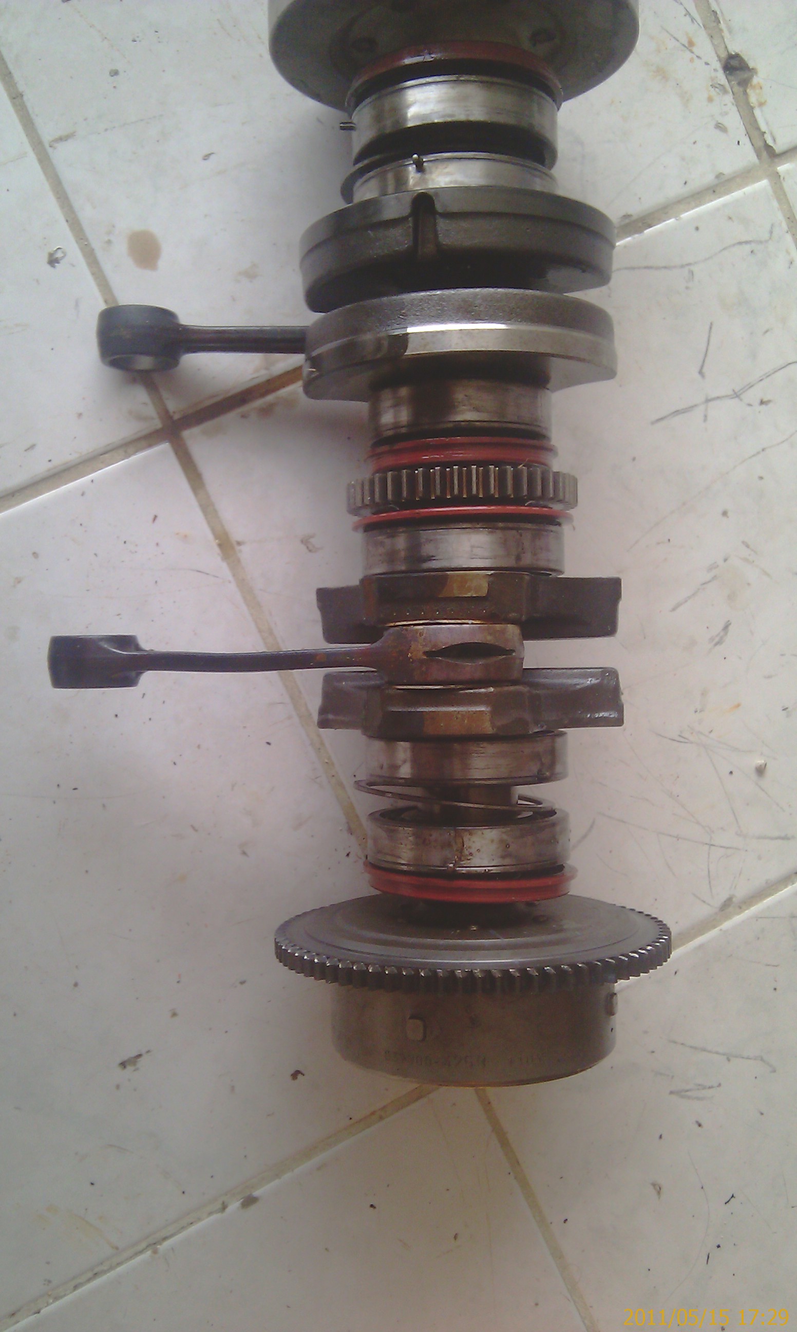

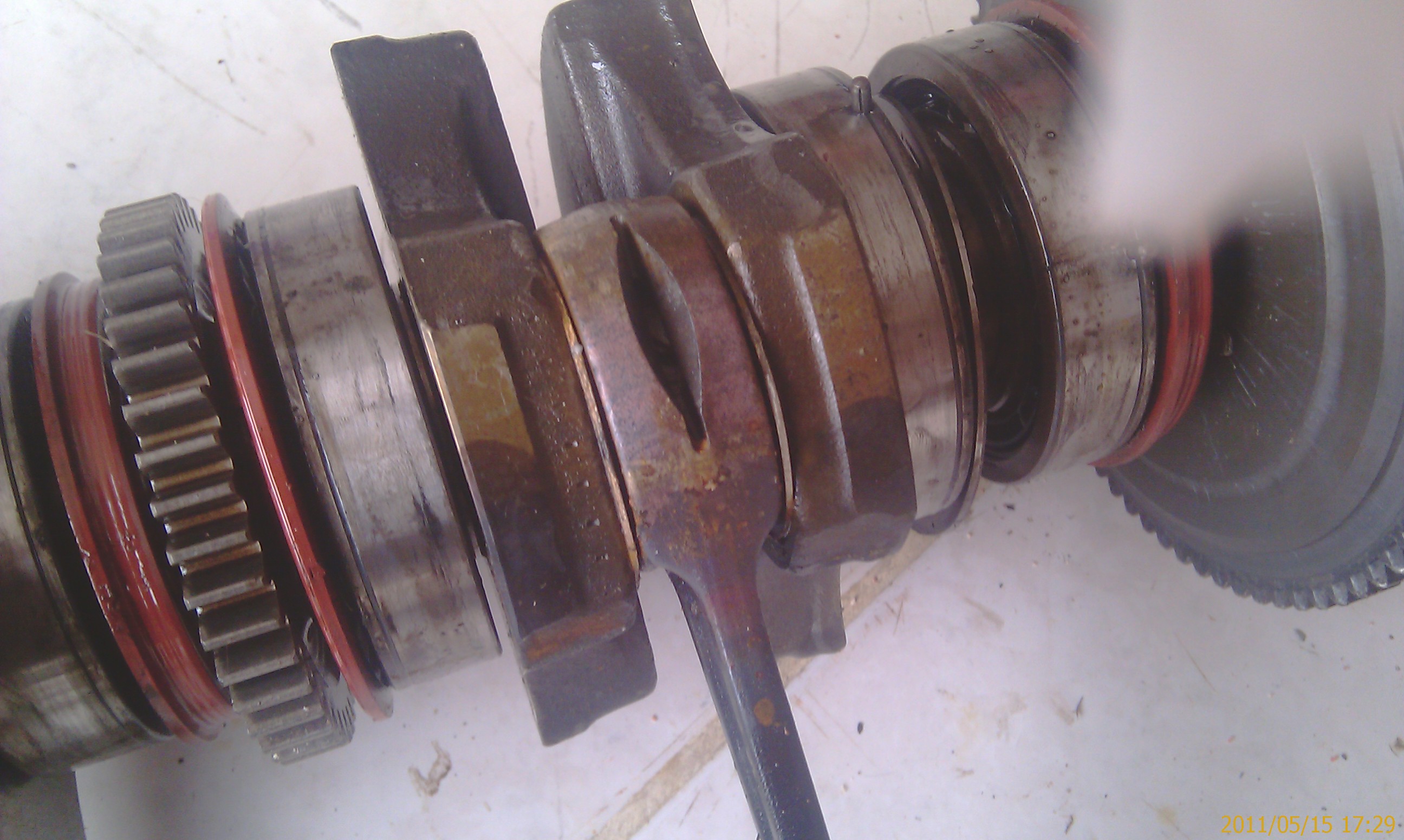

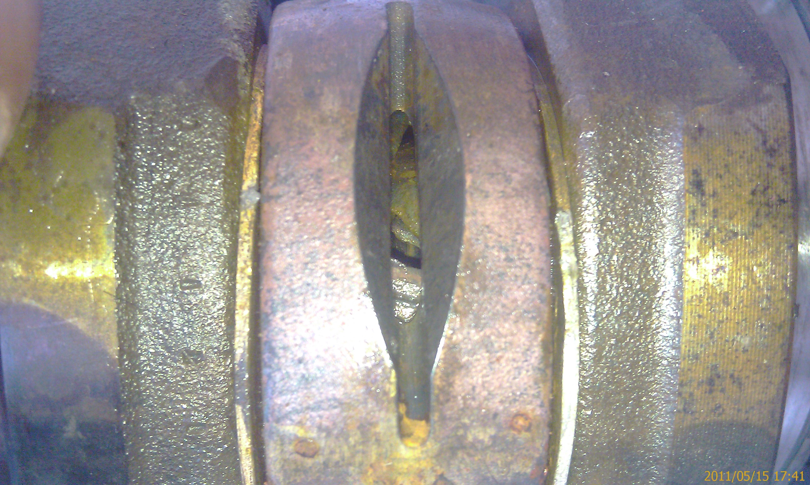

one cylinder, the same side that has the bent rod, shattered one "skirt " of the cylinder and the pieces were trashed in the lower crankcase by the crankshaft and made a hole in the crankshaft...the spark plug in that side, the electrode shifted about 1/4 inch up in the plug base and the upper ceramic portion of the spark blew away... I will attach some pictures here
One thing that is confusing is that it looks like the pieces of the cylinder got inside the rod on the lower bearings...

You might have had water in the engine at some point and started rusting the lower rod bearing, that would cause the failure that we see, that would explain the bent rod tooSBT Tech Support is here to help with your problems.

Also I cant see any excessive heat signs on the lower part of the rod to blame it on the oil, most of the time you see a rod bend like an S shape its from a hydro loc, that engine may have bent that rod a while ago from water intrusion and the water started rusting up the lower bearing and then it failed.SBT Tech Support is here to help with your problems.
