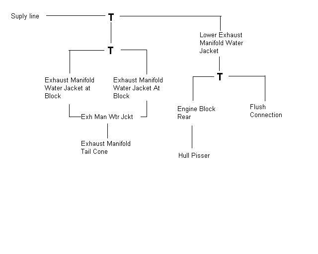

          The way this Coffman pipe is set up is this:
          3/8" line coming through bulkhead comes to a 'T'.
          One side of the 'T' goes to the bottom of the exhaust pipe.
          The other side of the 'T' goes to another 'T'.
          Each side of the second 'T' goes up to the exhaust manifold right where it bolts to the block.
          From the first 'T' that goes to the bottom of the exhaust, water travels through the exhaust pipe water jacket and goes exits up about 8" into a line that goes to the rear of the block/cylinder head. There is a 'T' in this line that goes to the flush hose.
          A line comes off the top front of the head and exits through the pisser.
          Finally, a jumper line crosses over a 5" exhast hose that ties the two halves of the exhaust together (at the very top), and another line comes off the downstream half and dumps into the tail cone.
          I'm assuming that the water from the two lines entering where the exhaust bolts to the block is the water traveling up to the crossover and the line entering the bottom of the exhaust is the one coming out and going to the back of the block.
          When flushing, everything runs cool to the touch. When on the water, everything is very warm although it isn't hot enough to burn.
          I'll check the inlet hose for clogs.

            I've been looking over the cooling line arrangement in my ski. The supply line comes from what I assume is the high pressure side (downstream of the impeller) of the jet.
            I'm wondering what type of flow rate I should be expecting. I'm also a bit concerned that with the aftermarket exhaust and all the Tees installed, there may not be enough flow.
            Here's how it's set up (please forgive the crude drawing):
            Supply Line --------------- TEE --------------------------------|
            | Exhaust Manifold
            ----------- TEE -------- Lower Elbow
            | | Water Jacket
            Exhaust Manifold Exhaust Manifold |
            Water Jacket Water Jacket ----- TEE -----
            At Block At Block | |
            |-- Exh Man Wtr Jck --- | To Engine Flush
            | | Conn
            Exhaust Tail Hull Pisser
            Cone
            All lines are 3/8". The problem is that in the water everything is very warm (not quite burning hot, but uncomfortably warm) and not much of anything flows out the pisser. However, on the hose everything is cool to the touch and water shoots several feet out the pisser.
            There doesn't appear to be any blockages as the hoses flow fine. How cool should the engine/exhaust be running in the water? Cool to touch as on the the hose? How much water normally flows out the pisser while scooting along in the water?

              Re: 95 WaveRaider 700 cooling
              Well, that drawing attempt looks nothing like the way it appreared in the Edit window... all the spaces were removed....
              Here's a crude .jpg of the setup...
