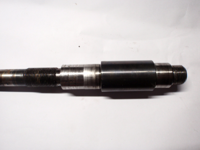

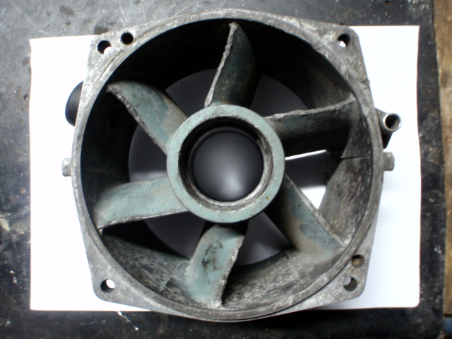

Tahnk you very much for your support and my apologies for late reply on this subject. I have attached a picture of the rear side of the shaft (the only piece I have as it has been cutted), the pump and the duct intake if that can help. I have re-assembled the duct intake, impeller housing and pump and made a measurement : it looks like that shaft should be measuring around 85 centimetres. I have made some research on internet and some people say that this is the engine and propulsion of the wave runner III 1991 to 1995.
Shaft measures are as follows :
inside pump bearings axle diameters front and rear : 25 mm
Lenght of the front bearing axle : 38 mm
Lenght of the rear bearing axle : 17 mm
Impeller thread diam : 20 mm
Shaft diam : 18 mm
Pump :
Outer oil seal diam : 42 mm
Inner diam : 25 mm (bearing axle diam)
Impeller diam : 145 mm
