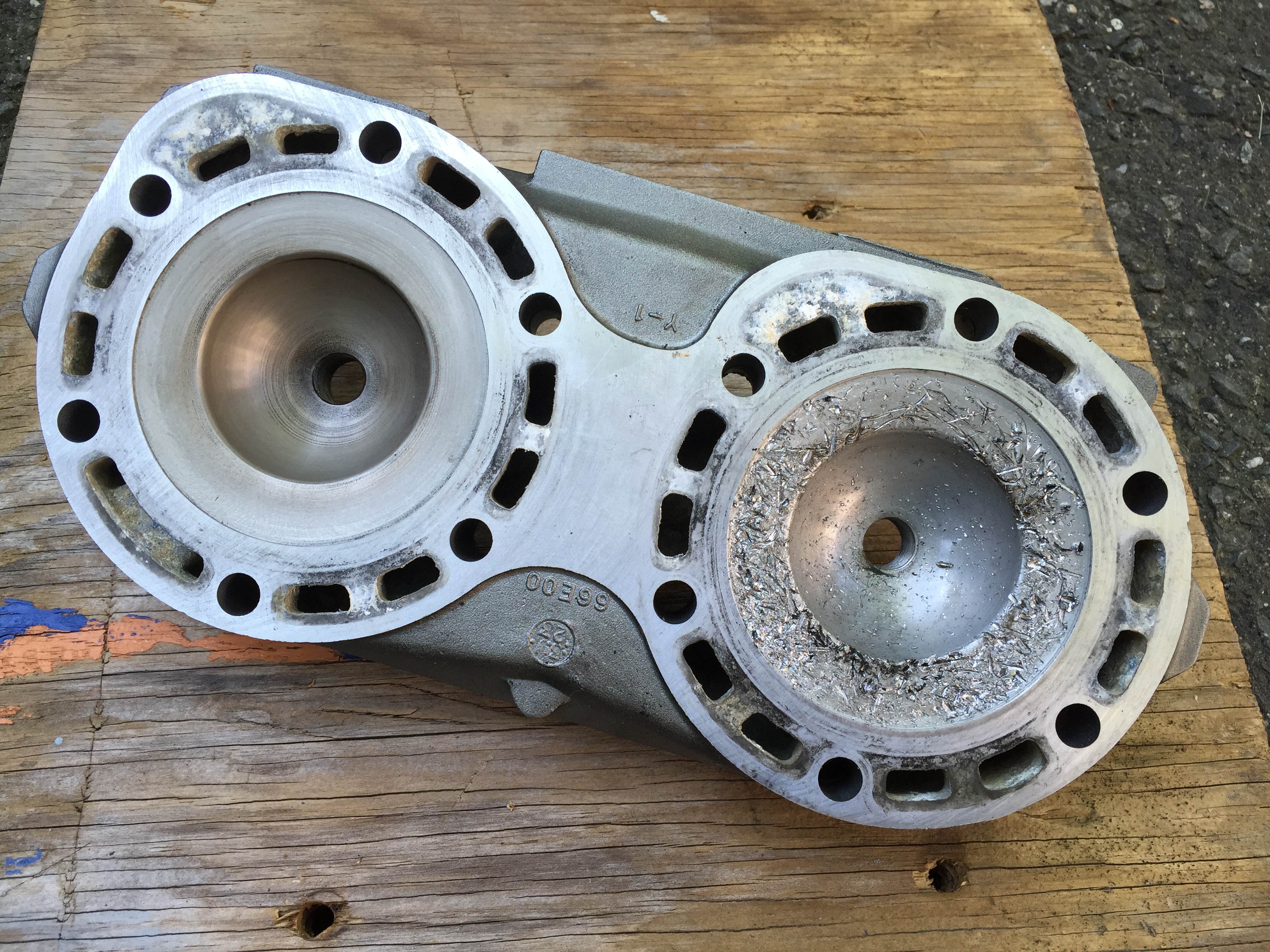

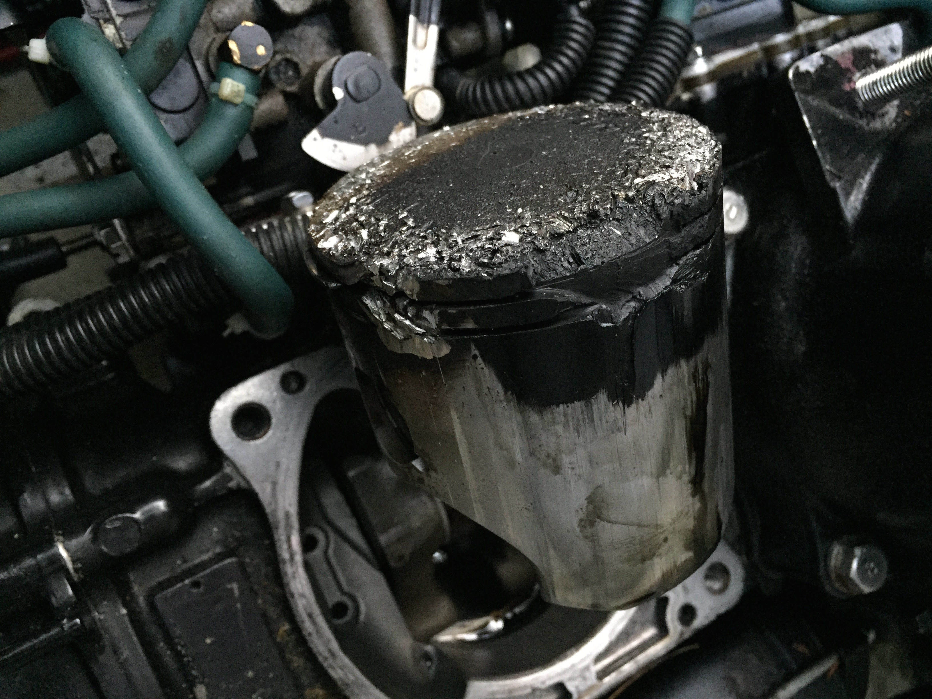

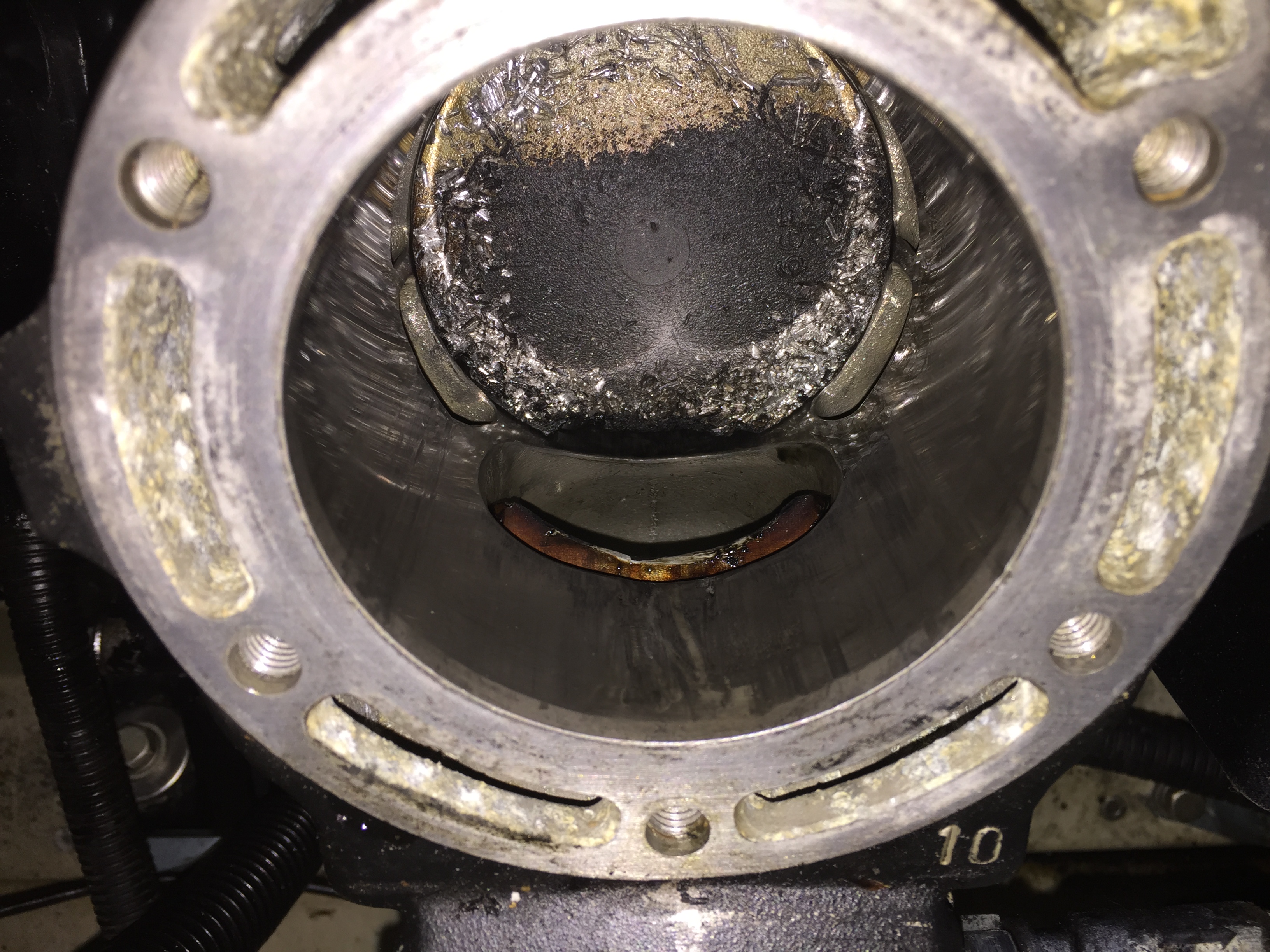

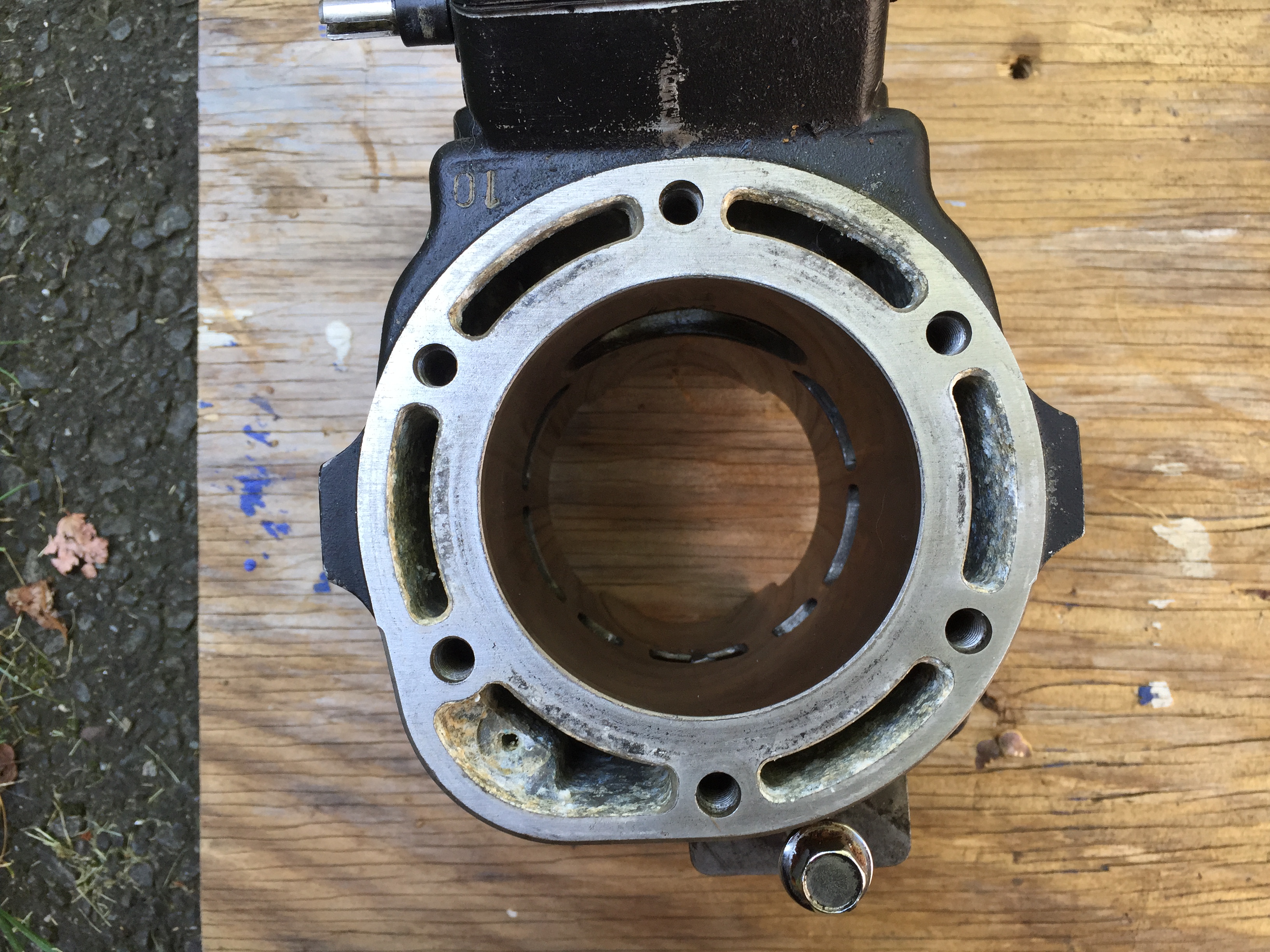

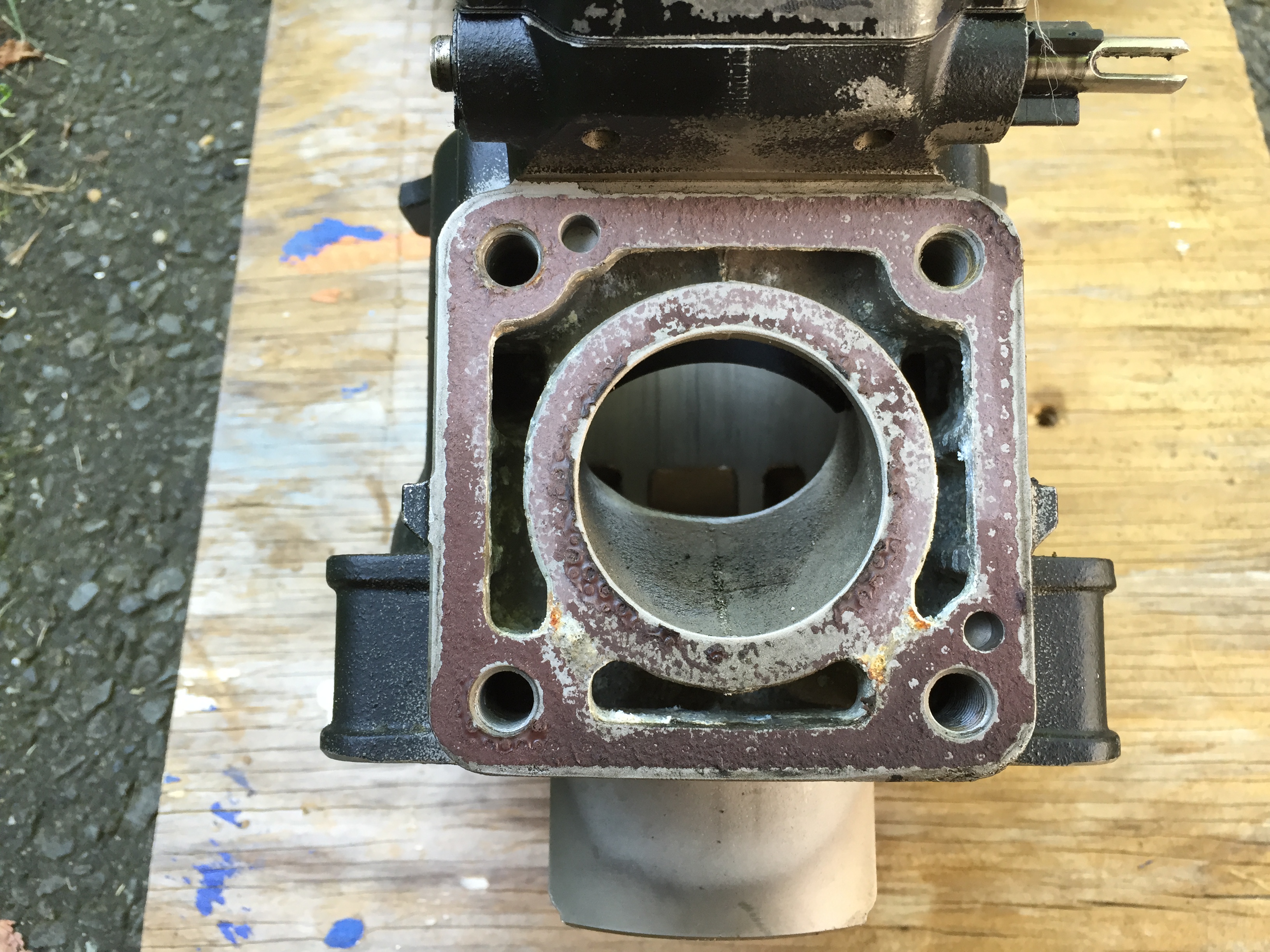

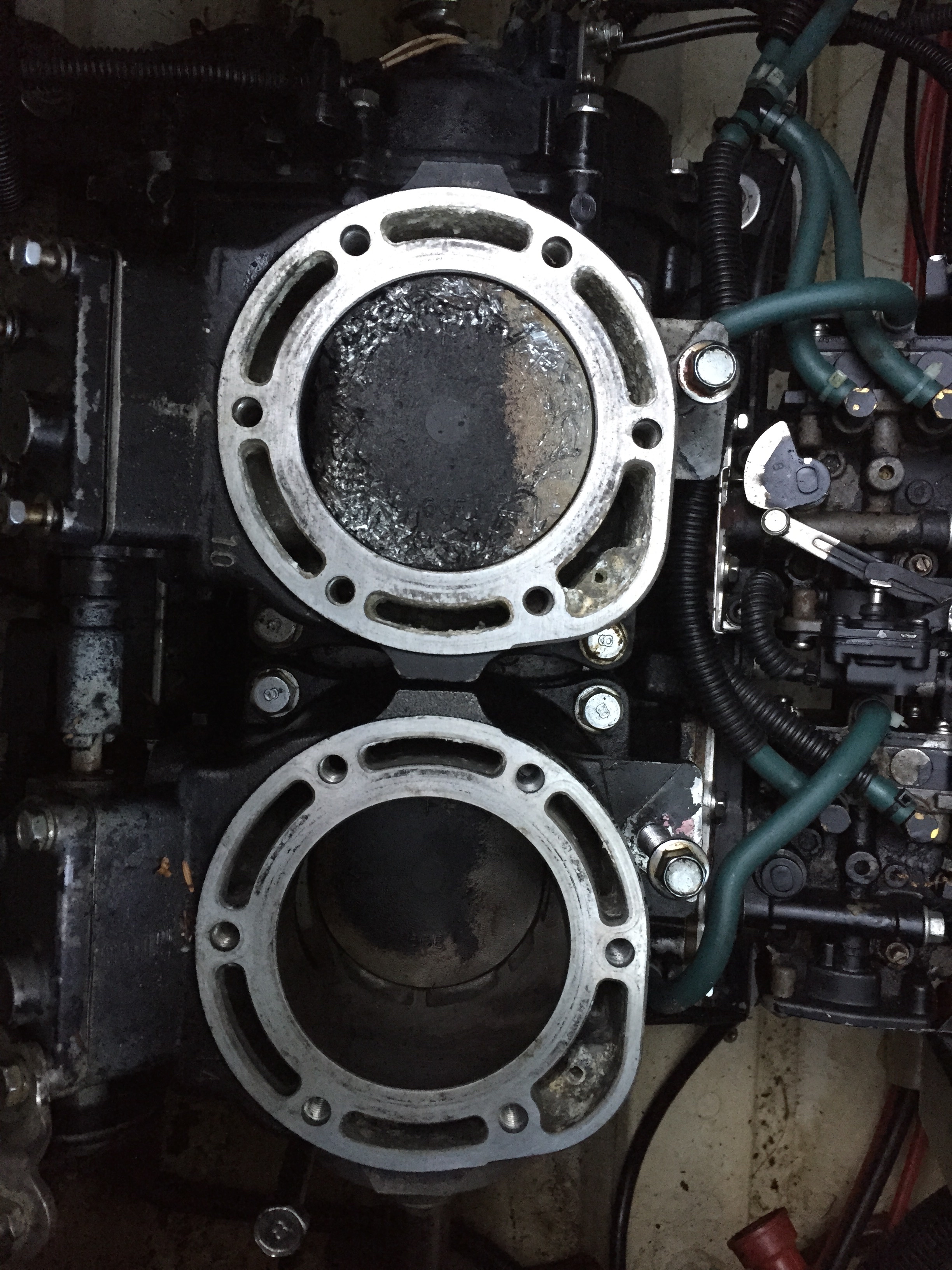

Once back and investigating, determined the compression on the front cylinder was shot, back was still strong. I know the common problems with these engines are the power valves and the oil injection, both of which I was planning on taking care of but now definitely will be. But I do not think either of those were the culprit here.
The power valve pin is not broken and it did seem to slide up and down reasonable even though it was clipped. Bottom of the skirts were in good condition. There is some liquid in the crankcase which I am going to soak out tonight, looks like gas oil mix.
Trying to determine what caused this, don't want to put it all together and have another incident because I missed a critical aspect. Was planning on doing a top end kit but really want to hear the opinions of the experienced.
